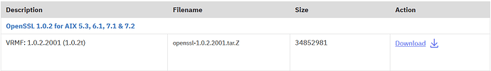

p.s. when I manually goto https://www-01.ibm.com/marketing/iwm/mrs/DownloadList?source=aixbp&lang=en_US I can see the files

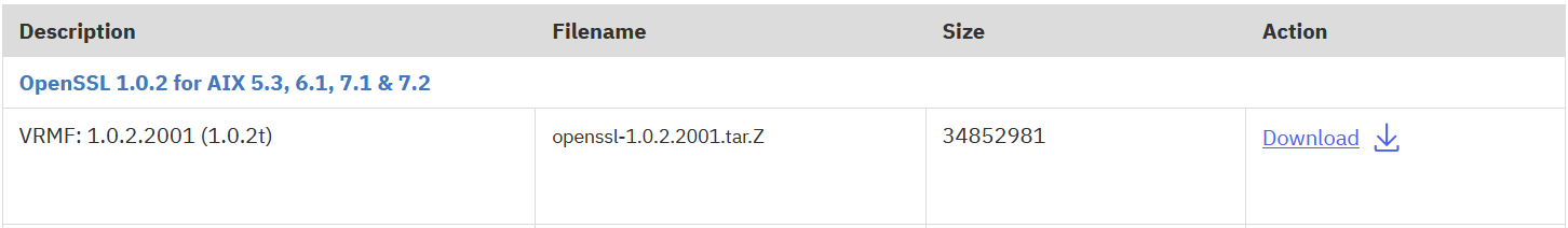

- When I copy/paste the login URL I get taken to a page to login, and I get the list of files available.

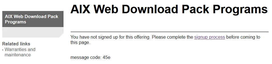

- Now that I am logged in, I try the “Getting page” URL - and it says, sadly - You have not signed up for this offering. Please complete the signup process before coming to this page.
message code: 45e

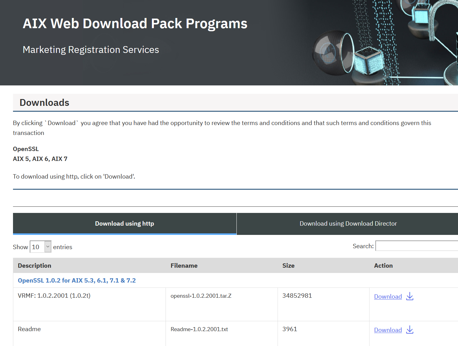

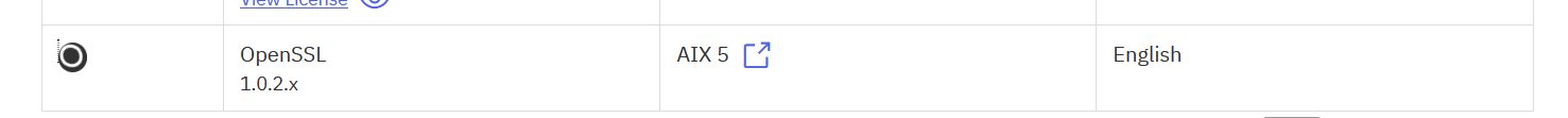

These days I use the link: ROOTVG - AIX, LinuxOnPower & POWER Systems Portal - Offline (that points to Log in to IBM). After login I am at page: https://www-01.ibm.com/marketing/iwm/mrs/packageList?source=aixbp&lang=en_US . On this page I see, e.g., OpenSSL.

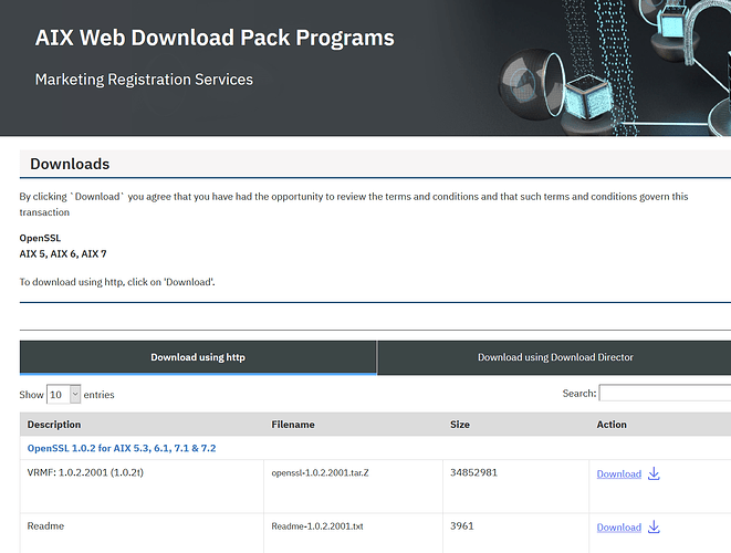

After pressing “Continue” I land on page: – actually - it does not say - the URL in the browser is unchanged. A frame has been filled with new data.
Note - the Browser tab calls itself “MRS” which is in the page banner as: “Marketing Registration Services”
The “Download” links are not “generic” - they are probably dynamically generated - and look nothing like the “Getting page: URL the plugin is generating” - bother!!!
