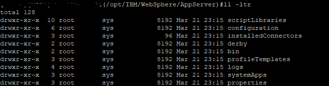

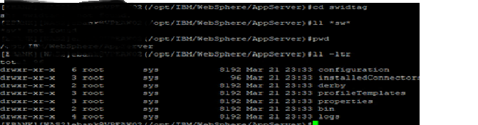

This is the current directory content. ILMT is running version 9.2 with BigFix 9.2. I've tried scanning and uploading without success and the server was restarted. Since Installation Manager was used for uninstallation, and it's documented the following:
Cleaning your HP-UX system after uninstalling the product
  1. Use Installation Manager to uninstall the product.
  2. Type rm -rf app_server_root to remove WebSphere Application Server directories in the app_server_root directory.
Do you think deleting the entire directory might make a difference?
I would really appreciate your help.

Thank you Jason for your help now is working.
