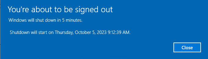

A couple of things to note:
Using this command will cause a notification to be displayed like the one below to any logged-on user:

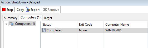

Using the command with the delay will allow the client to report to the console and you will get a ‘completed’ status before the machine actually shuts down.

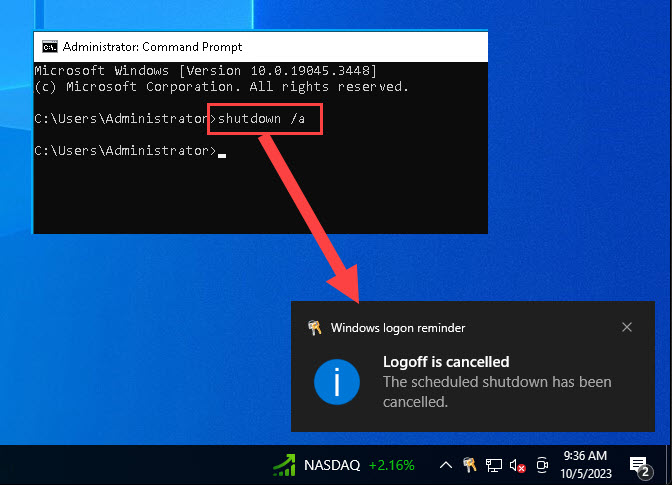

Lastly, bear in mind that if a logged on user sees the notification, they can issue a ‘shutdown /a’ command to abort the shutdown you issued). As such, you may want to play with the delay time so that you give your device time to report, but minimize the amount of time any user has to countermand your action.

Thank you for your comprehensive post. It makes sense to me and is consistent with everything I’ve seen while testing various scenarios. At this time I’m using a 60-second countdown and getting a Completed status.
