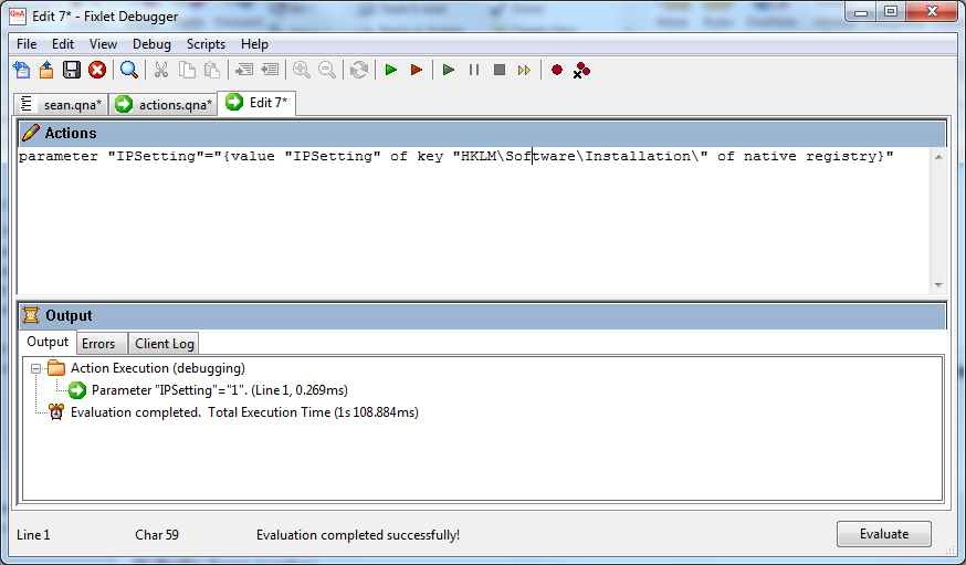

I think you just have to surround your right side of the parameter with curly brackets and quotes. This works for me:
parameter "IPSetting"="{value "IPSetting" of key "HKLM\Software\Installation\" of native registry}"
The only thing I did not try was putting it in both Curly braces and “” … and that’s what does the trick
Thanks for also letting me see that I can actually use the fixlet debugger to try this out. I was constantly pushing the task to see if it ran or not…
