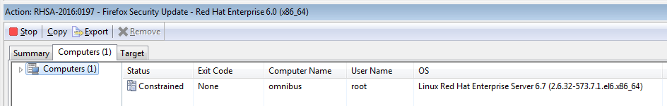

I generated an action to deploy a Fixlet (Firefox Security Update) to a RHEL 6.7 server and set the following constraint condition:
“Run Only when: User Name contains root”
Since there is no user on the console it correctly evaluates to “Constrained”; however, I then logon to the server (Console, not ssh) as root. The user name retrieved property then shows root as the user, but the action never leaves the Constrained status.
I’m also including the action’s behavior summary:
And I’m attaching a copy of the action in case anyone would like to audit it.

The requirement is that this action execute on the client only when ‘root’ is logged in to the computer. That is a customer requirement and by all accounts the product has the ability to do this so I set it up that way. To be honest, the “why” in this case is not really relevant as it is a product feature that does not appear to be functioning as expected.
I posted some screenshots in my OP (I can see them, but definitely let me know if you can’t) where it shows that when ‘root’ logs in, the “User Name” property changes to display root as the value. This should trigger the action to start execution.
The question is : Why doesn’t it?

But what you said got me thinking: The “User Name” field is is a STRING that can have any of a number of values. The relevance for that field is similar to the one you posted except that the result of yours is a BOOLEAN type…I figured, can’t hurt to try so I created a new retrieved property that instead of displaying the logged in user just checks for ‘root’ being logged in and displays TRUE/FALSE…
BOOM! THAT WORKED! I started the action with the constraint based on the new ‘Boolean-type’ property (when matches True). The endpoint has no user logged in so the action correctly showed ‘Constrained’, then I logged on as root and it kicked off right away (with the already pre-cached content).
So while that’s not what you meant in your reply, your re-writing the relevance in Boolean rather than String format made me look at the process in a different way.
Thanks again…And also thanks to ‘BigFixNinja’. Problem solved.
