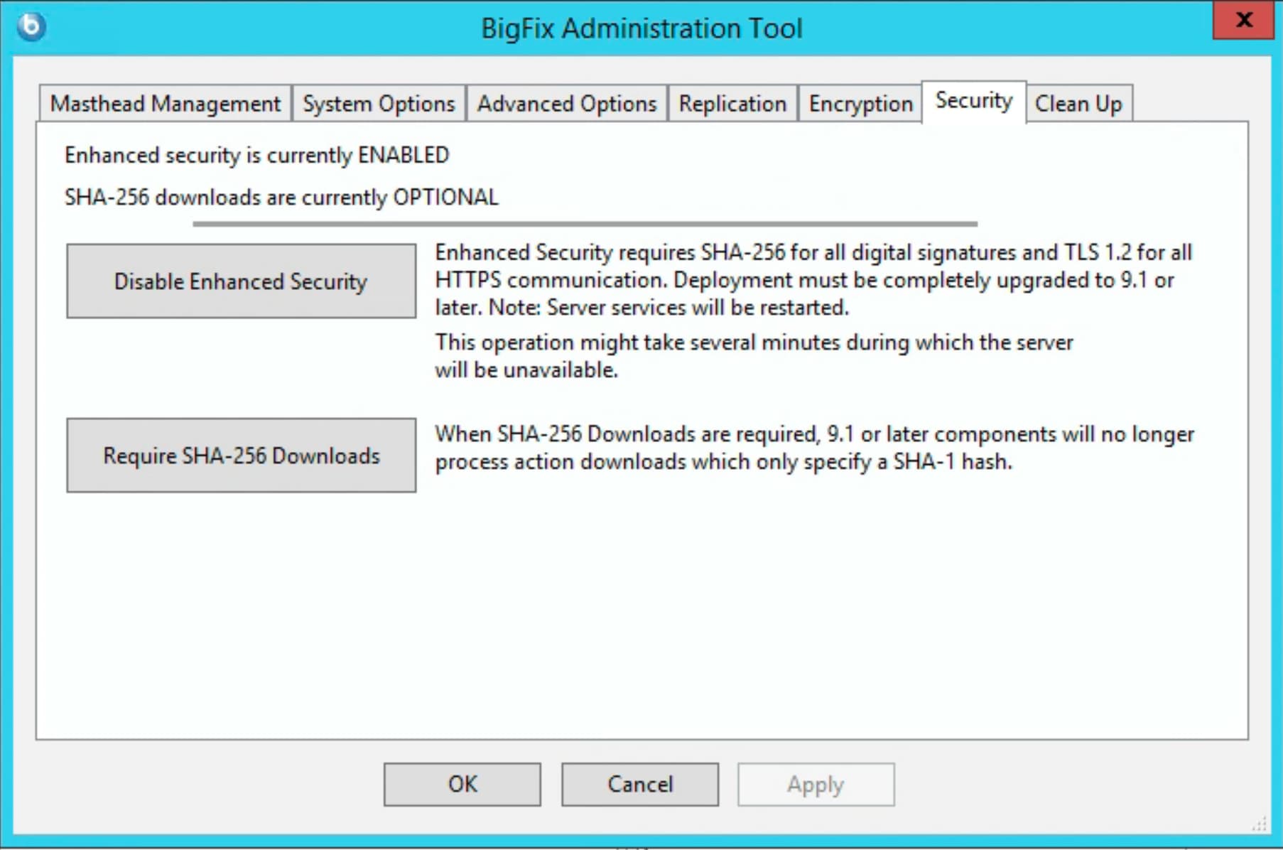

Hi @ersaumitra10 ,
Thank you for your help. I got a hold of the admin tool and here is a screenshot of the security settings.
I am yet to run the curl command and will ley you know the outcome once it is done.
Thanks again

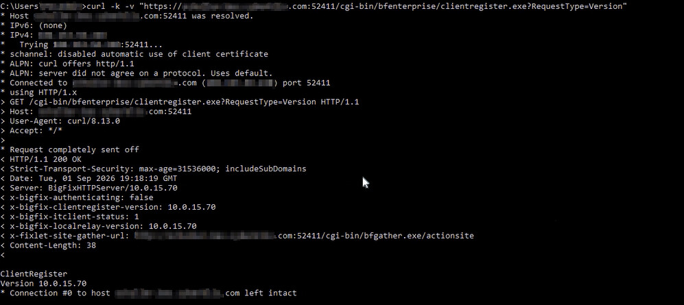

hi @ersaumitra10 ,
Thanks again for your help. This is a result from running the curl command
Please let me know if you need any other information. Thanks
Thank you for sharing details. I have gone through initially I thought the issue is more likely with TLS1.3 but handshake is happening.
Since the curl is ran from user account, Re-run curl, but as SYSTEM (e.g., via PsExec -s) to match BESClient's actual execution context rules out a user-profile-vs-SYSTEM cert store difference.
Check the BESClient.log on affected machine to see if any SSL/GSKit error code around the "SSL protocol not supported" line (not just the summary text)
On one affected machine, check registry: HKLM\SYSTEM\CurrentControlSet\Control\SecurityProviders\SCHANNEL\Protocols\TLS 1.2\Client confirm Enabled=1 and DisabledByDefault=0
One more step I would do is to manually perform clean re installl of bes agent on one of the affected machines to clear any stale Crypto state.
Also if zscaler or any other application is used it's worth checking with team in case any blocking is happening from their end as they apply some different policies.
Also, I would suggest here to involve hcl support as on remote session they can look into the logs more precisely
