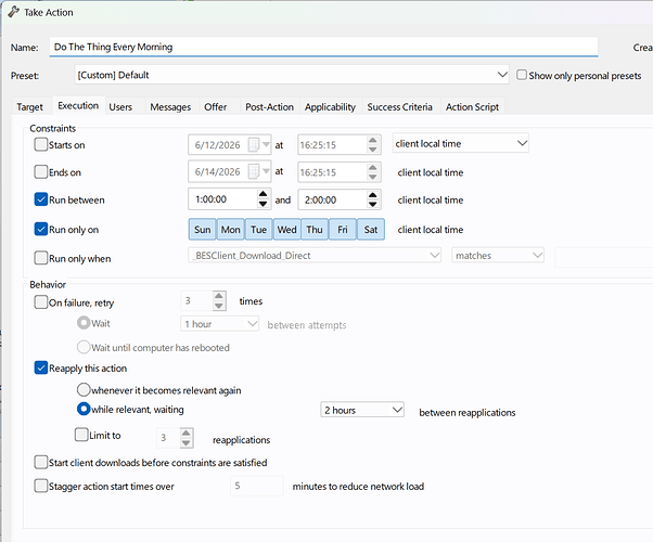

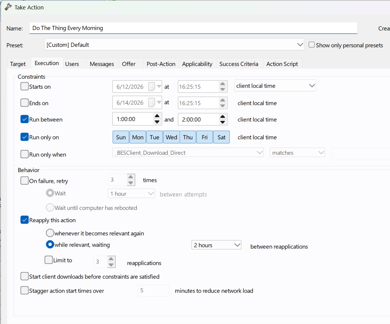

I totally think it's worthwhile to troubleshoot and determine why these clients are not processing the actions sent by the API user account, but, I also have to wonder, for this very specific action have you considered sending the action once, with settings to reapply daily?
Something like the following I think would work:
'Run between 01:00 and 02:00' means the action can only run during that one hour of availability; if the client is busy doing something else, or the computer is turned off, the action won't try to 'catch up' by running outside of that designated time.
'Reapply', 'While Relevant, waiting' means that the action doesn't have to be 'Fixed' and then go back to 'Relevant' to repeat (as 'whenever it becomes relevant again' would required).
And waiting 2 hours between reapplications means there's no chance of it running twice in one day, that one-hour block from 0100 to 0200 is too short for the action to run a second time.
