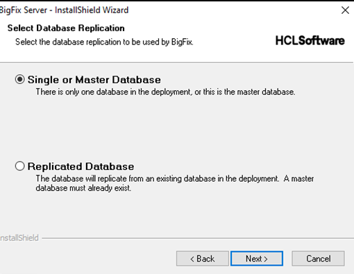

that’s a valid point. Sounds like my best course of action is to provision a new web report server in the same network as the DSA server. This will be my first time doing this. When installing the report server i’m assuming the only differences would be to select “Replicated Database” and when specifying db connection details to use the same DB engine the DSA Server is using. Is that accurate?
Yes that’s correct.
