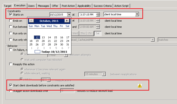

Have you tried the ‘Start client downloads before constraints are satisfied’ option in the “Execution” tab of “Take Action” Window?
When it’s selected, download will start right after the Fixlet is deployed while the action will be taken at the future date you specified.

The download caching is handled automatically behind the scenes. It doesn’t require a separate task to do the download.
