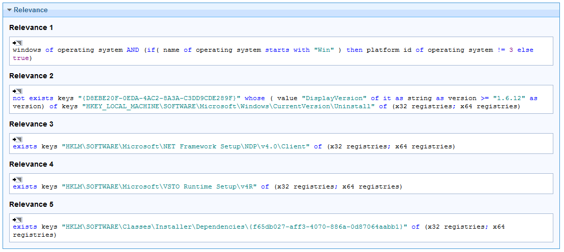

Jason, I know you are wary of the relevance, and believe me I know relevance can get into hair-pulling territory. But you may not realize that you pretty much already have the relevance with your registry checks in the batch file.
I built a baseline to test since as @strawgate mentioned it’s the “right” way to do things, and I was able to install your prerequisites and PollEverywhere successfully. Like he said, just use the Software Distribution Dashboard to upload and create tasks for each app individually. Then use the registry keys to add to the default relevance for each of those packages:
For the VS 2013 redistributable:
not exists keys "HKLM\SOFTWARE\Classes\Installer\Dependencies\{f65db027-aff3-4070-886a-0d87064aabb1}" of (x32 registries; x64 registries)
For the VS 2010 Office Runtime 4.0:
not exists keys "HKLM\SOFTWARE\Microsoft\VSTO Runtime Setup\v4R" of (x32 registries; x64 registries)
For .NET 4.0:
not exists keys "HKLM\SOFTWARE\Microsoft\NET Framework Setup\NDP\v4.0\Client" of (x32 registries; x64 registries)
For the Poll Everywhere relevance, include the previous relevance statements (but remove the “not” from the beginning, because you only want to install Poll Everywhere if the keys do exist) and add this one:
not exists keys "{D8EBE20F-0EDA-4AC2-8A3A-C3DD9CDE289F}" whose ( value "DisplayVersion" of it as string as version >= "1.6.12" as version) of keys "HKEY_LOCAL_MACHINE\SOFTWARE\Microsoft\Windows\CurrentVersion\Uninstall" of (x32 registries; x64 registries)
So the Poll Everywhere relevance ends up like this:

Your relevance had some issues. I fixed them in the text. key needed to be pluralized to keys if it is going to reference (x32 registry; x64 registry)
Also, (x32 registry; x64 registry) should be pluralized to (x32 registries; x64 registries) so that it will work on 32bit systems without throwing an error. I didn’t make this change.
