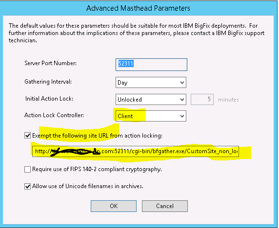

If you do NOT see this setting, then you system is set to only allow locking at the client level. Which is done in the BES Admin tool (not recommend). See below the “Action Lock Controller: client” ← this means you can’t control locking from the console ----
If you CAN do this, then you can lock and track any locked machines with this setting (even make a Task/Fixlet to target multiple machines). Just remember, that when/IF you un-lock it, the endpoint will start to process any and all open actions against it. Hence why i like to use the LOCK OVERRIDE site -
anything I put in this site will run on endpoints even if locked.
