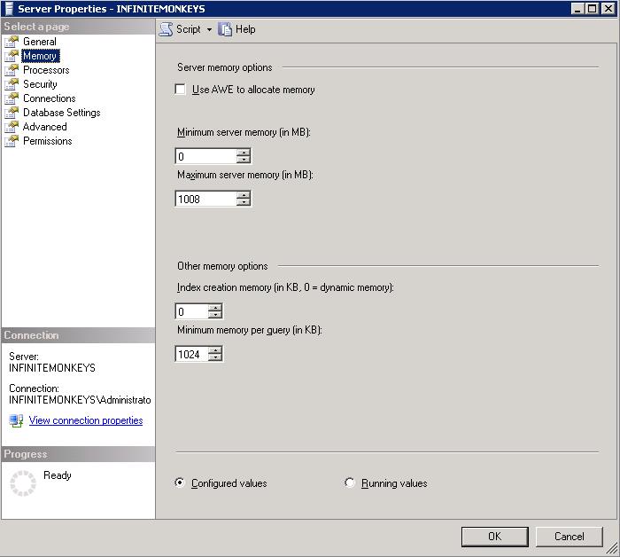

Here is a thought just to double-check (it sounds like you have done this already, but thought I would double-check):
  • Right-click on your database in SQL Server Manager and go to “properties”.
  • Go to “Memory”
  • Do the settings look right?
http://support.bigfix.com/images/miscscreenshots/sqlserver-memory.jpg
Until you get the sqlserver.exe memory up to many GB, I would expect BigFix to be non-functional in all the ways you mention and more (slow console, full bufferdir, slow results update, filldb error messages, etc)…
