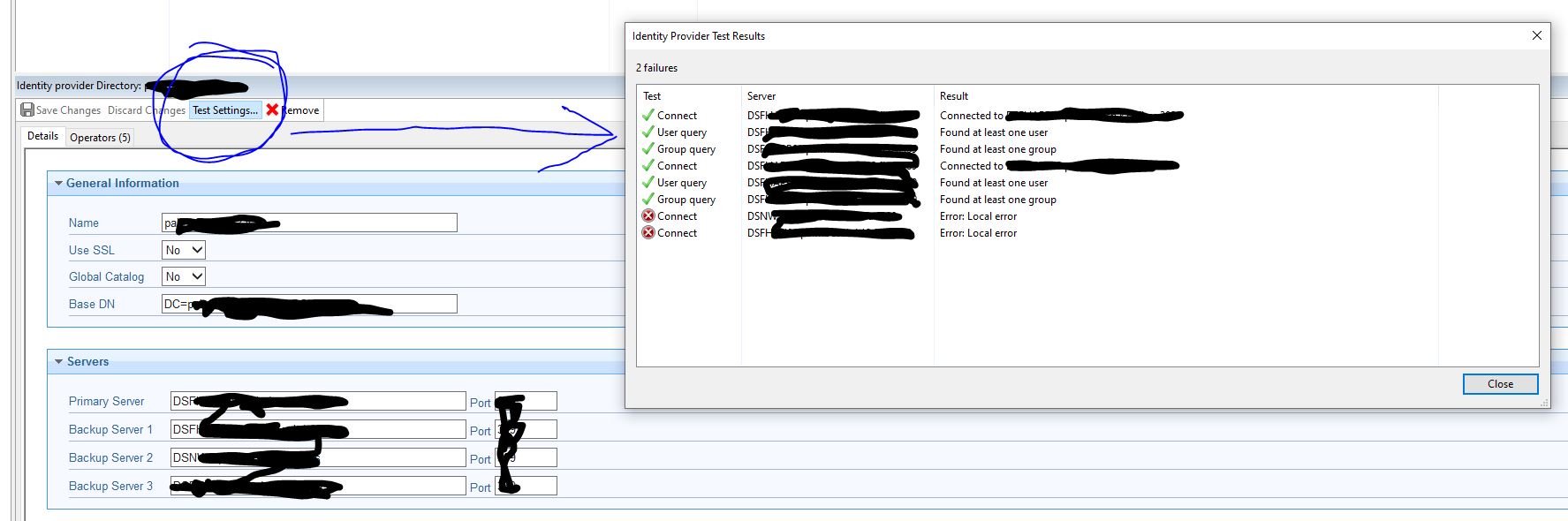

BF Compliance - Linux Master Server - Console AD integration no longer working – using the Console and the " Identity Provider Directories " section – i add 4 AD / DC servers port 389 – hit " test settings " and sometimes 1 server " connects " sometimes 2 servers " connect " sometimes no servers connect – its all hit and miss

Capture8
Capture9
