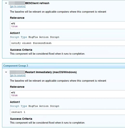

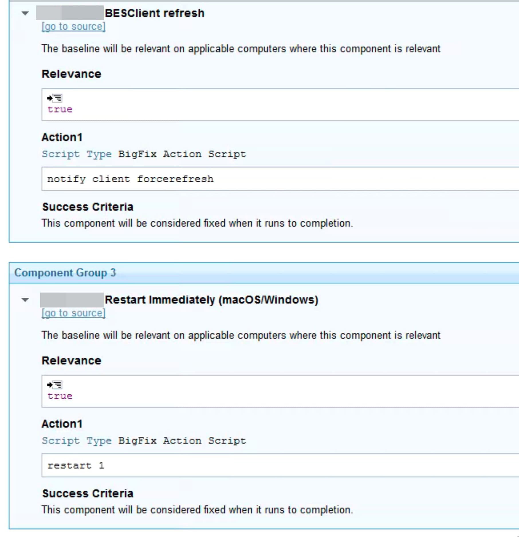

Some of the content in the baseline should always run, so I have their Relevances set to true. However, the machines sometimes report back "Not Relevant", or run into other weird issues for content that should have no trouble running.
For example, these are the last two items in the baseline, BESClient refresh, and Restart Immediately:

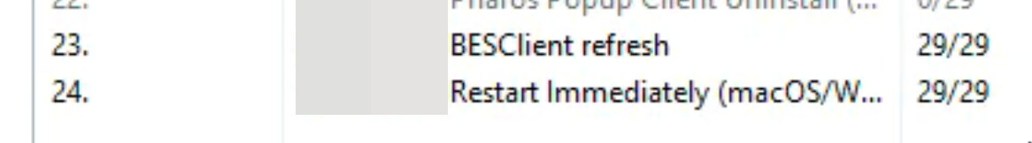

When I look at the Component Applicability, all of the relevant machines report the component as applicable:

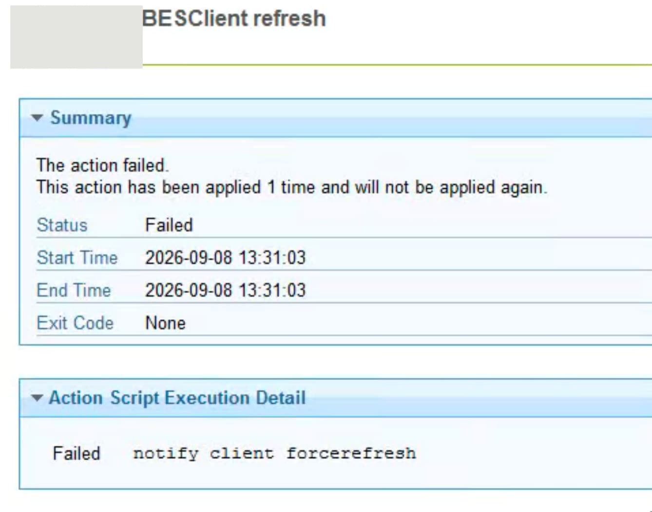

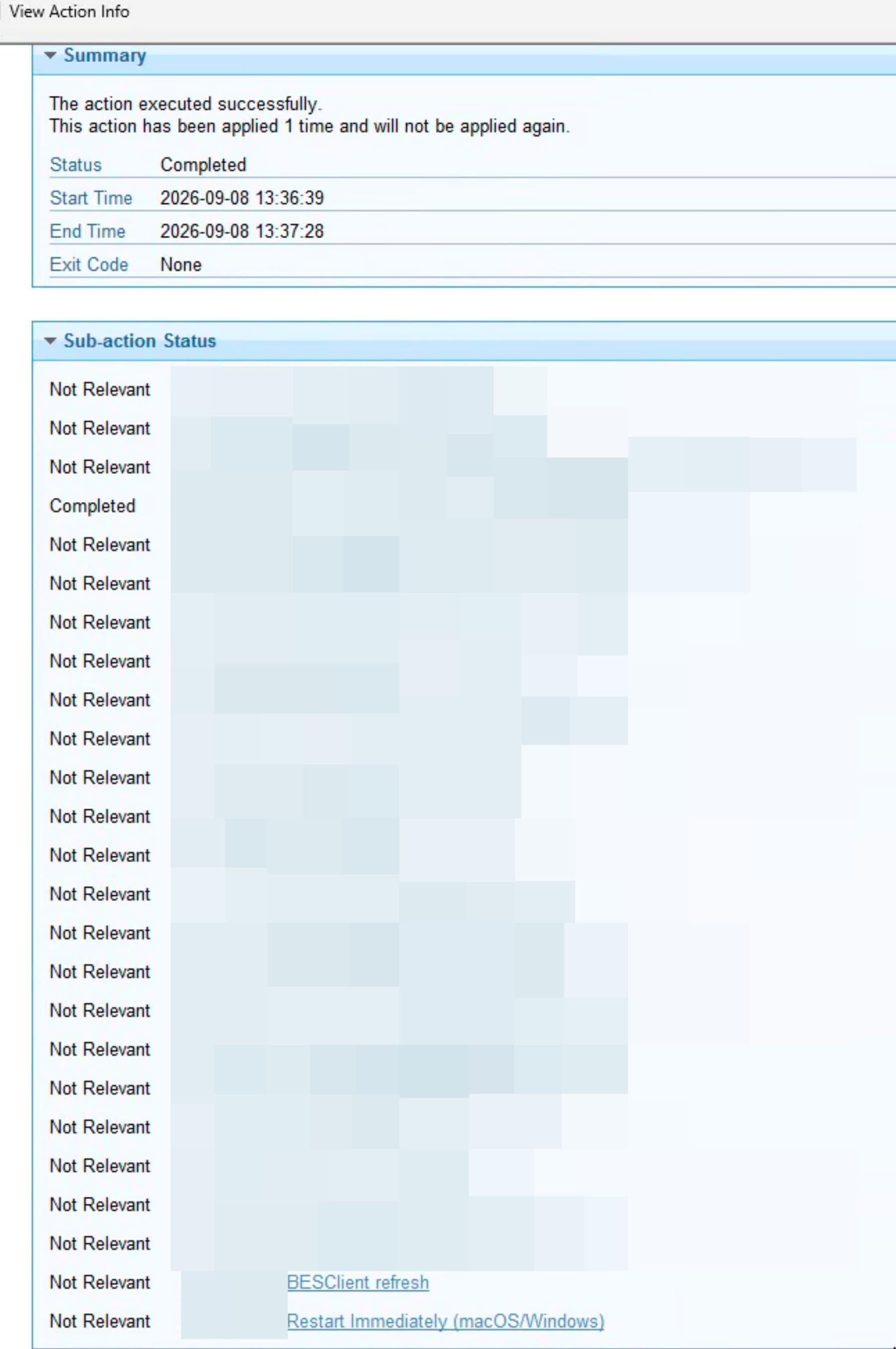

However, on the devices, I see things like notify client forcerefresh failing:
(the same fixlet ran successfully right after when deployed outside the baseline)

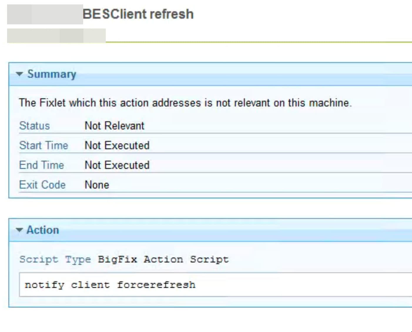

or getting reported as Not Relevant:

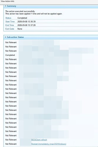

The same/similar happens for the Restart Immediately fixlet:
On these machines, they indeed did not reboot as expected, so the content didn't run. The same fixlets/tasks run just fine on the same devices when ran outside the baseline, so I'm not sure where things are getting mixed up. What could cause a device to report a fixlet with Relevance true as Not Relevant?
One potential I see right away is if you have a Fixlet that just does “notify client forcerefresh”, I imagine it has no relevance to check if the server actually updated. If not, then it should be created recreated as a task.
As for other Not Relevant, you could have those tasks/fixlets unselected in the baseline to not make the baseline relevant if that component is relevant.

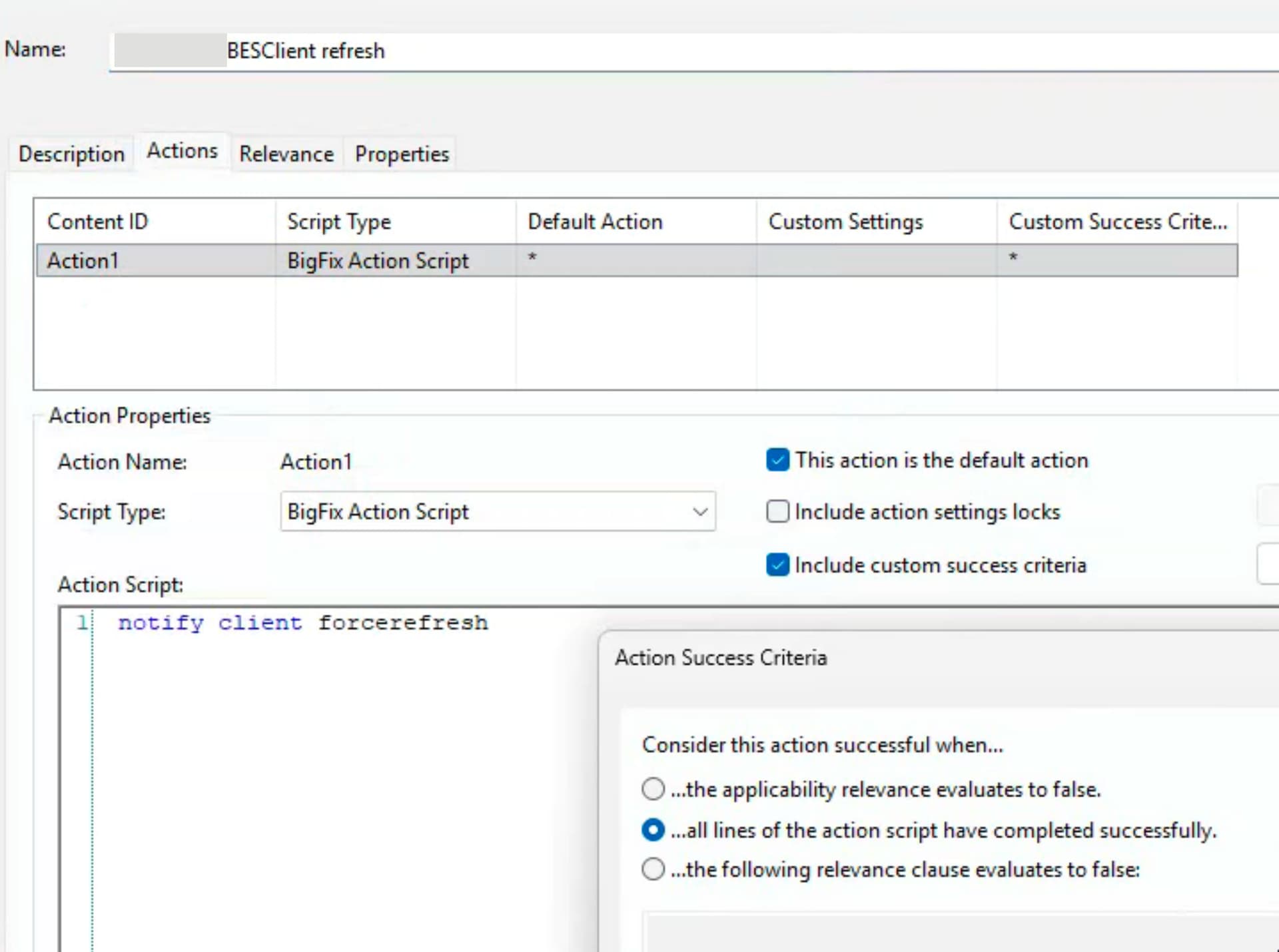

For both Fixlets, I have the success criteria set to "...all lines of the action script have completed successfully":
For the Not Relevants, I'm not sure how unselecting the items would help them run on the target client.
