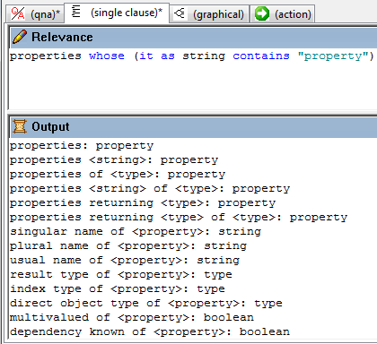

Alternatively, you might be able to use the ‘property’ inspector to return useful information about inspectors/properties from within the query tool/Fixlet Debugger itself:
