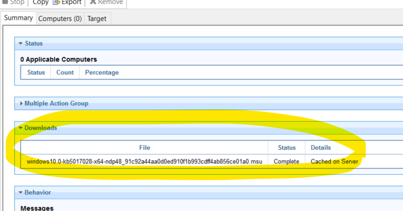

When you push the action, are you able to see the package is being cached on the BES Root server?
You should see something like this:
If that is happening then it sounds like something is happening with the download at the relay level.

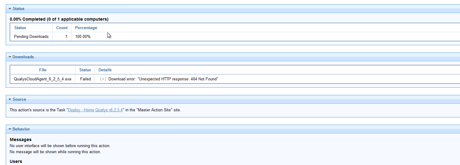

I receive a failed to download.

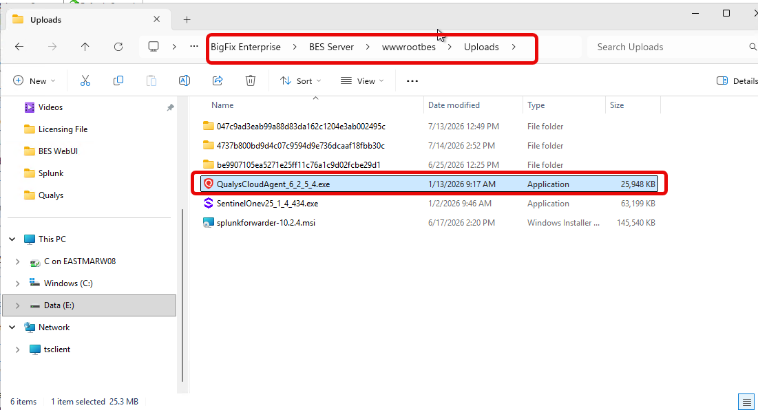

ok, that helps. Try with http://BIGFIXServer:52311/Uploads/QualysCloudAgent_6_2_5_4.exe
You are missing the ‘Uploads‘ part.
