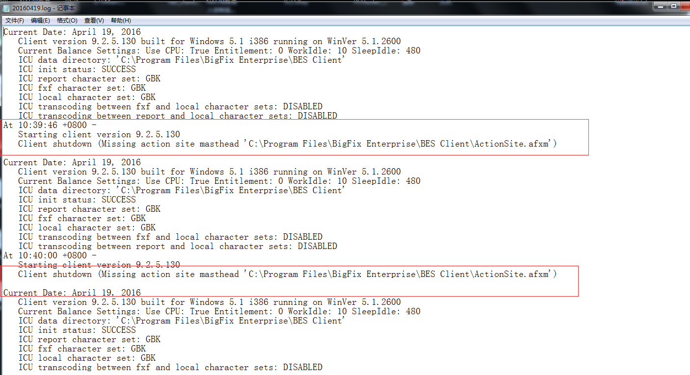

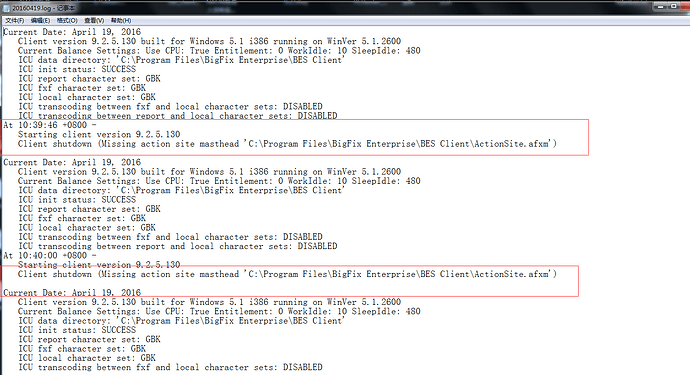

9.2.5 Agent installed missing file actionsite.afxm
9.2.5 BESClientMSI. msi installation,
the installation is complete later found no BESClient. exe process,
then found to be BESClient service did not start,
finally missing file actionsite.afxm under the installation directory,copy from the normal machine a actionsite. afxm ,start the service is ok.

The above screenshot is xp system, Another one is Win8 system
